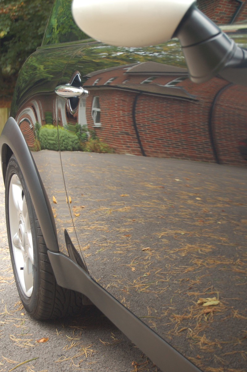

Here's an outline to mine and Moley's cleaning day!
- Wash car with warm water (2 bucket technique)
- Shampoo (2 bucket technique) I used Auto Glym Shampoo, Moley used a new Megs one, I think the Megs is better
- Rinse with warm water (2 bucket technique)
- Turtle Wax bug and tar remover (not sure this actually did anything!)
- Clay using megs clay and megs quick detailer
- Rinse all the residue off
- Dry using microfibres
- Polish using an applicator pad to put it on and microfibre to remove. I used Megs step 2, Moley used Auto Glym Super Resin Polish. Think the AG SRP is easier to remove.
- Waxed with Megs NXT wax. Put on all over car with an applicator pad, left on for a while then buffed with a nice big Megs microfibre!
JOB DONE!! yahoo
Takes about 3 - 4 hours per car, but well worth it!! yahoo

Pics added to first post peeps! Very Happy

Nice, love the reflections in the pics Smile

Nice one James, looks awesome! Especially me with a Pink micro in my pocket..... Shocked

Excellent effort guys really excellent! You have captured that wet look marvelously! 8) Some good pics too! I really love that last one with the tired cleaning cloths and sponges trying to escape over and through the fence! Laughing Laughing Iconic! thumbs up clap

Great looking Guys clap clap clap

Good pics, nice shine on the MINIs 8)
