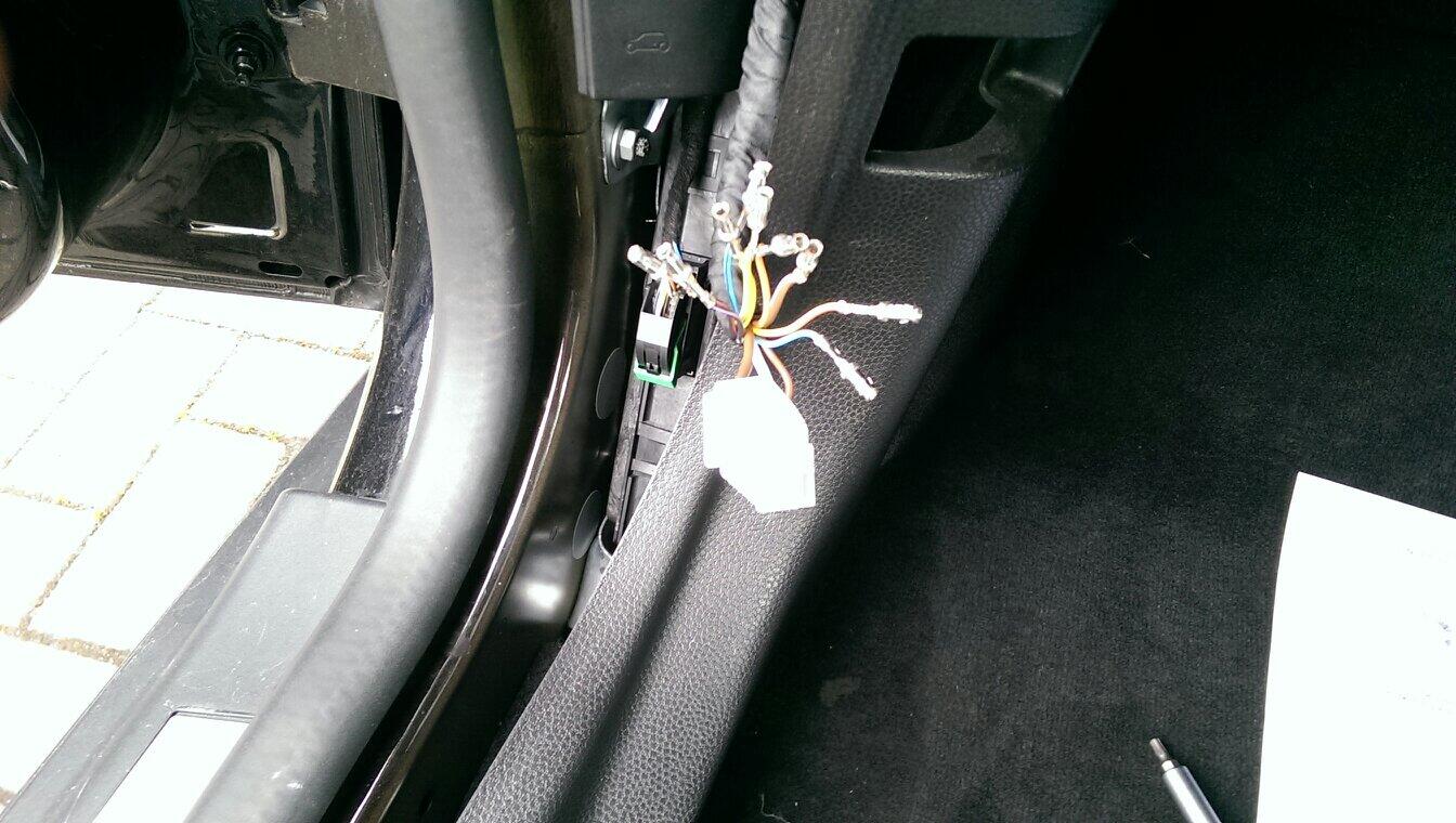

Naturally I had one wire which was a sod to get out, and one which was a sod to get back in! Sad
All sorted with a Torx size 20 to push the buggers out with, and pliers to push them into their new homes.

All together it probably took under an hour, spread over late morning/early afternoon.
I stopped for lunch at the point where I couldn't get that one last wire back in.
I wasted a lot of time with the one which refused, at first, to come out too.
Sound is much more purposeful, far better bass.
And here's a photo of the "OMG! WTF have I done?! moment
stereo swap channel - Page 2 BmKS9ZOIIAA3zz1
Last edited by Ricardo on 26th April 2014, 23:09; edited 1 time in total (Reason for editing : Typo, caused probably by beer consumption.)
