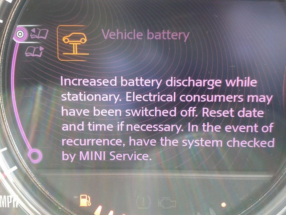

| My 2008 R56 Mini Cooper S (had from New). has this fault now for a while. I frequently have to set the date, time, etc. When I use the car the next day all the settings have gone and have to set it all up again. It’s got to the stage now I don’t bother setting it up. Guys any ideas My hunch it’s the Battery as it’s 10yrs now!!! But I don’t have any issues Starting the car. Help!! |

| Hi Len, I used to get this message on my clubbie for well over a year until I sold it, dealers always said give it a really long run but it still came up, not everytime I used it. Then spoke to a guy who seemed to know his stuff and told me one of the battery terminals (I can't remember which) has a sensor built in and is often the cause and not the battery. Could be your issue. Are there any fault codes as he checked mine and found one (can't remember the number) and no warning lights present but said it was the sensor.. If the battery I'd have thought you'd have starting problems! Or Will (TWG) might have an idea.  _________________  "Life's too short not to!!" |

| Yeah that'll be the battery, ten years is good going! Do you do lots of short journeys? Mine did that when it was getting on. |

| Thanks guys for your info & input. Dave I will give Will a ring to see what he thinks But as suggested it’s looking towards the Battery (sensor). Which I assume you have to change the battery itself!!! |

| Yeah I get you! £50 for a new one plus whatever it costs to code it to the car and jobs a good un! |

| Thanks Chris for your help and all you guys I rang Will, but he out. Will have to ring him again tomorrow. Dave on my Mini I don’t get any codes displayed. Looking up this sensor lead it looks like it’s built into the -ve lead. |

| Spoke to Will at TWG. Assured me it’s the Battery (10yrs) any slight voltage drop will cause alsorts of electrical related issues. Booked in with him for fault+Service. |

| Had my car Serviced at TWG today. Thank you Will, as always with great respect & care. NEW BATTERY fitted and everythings back to working normal. ie storing all the electronic info, etc and not losing it each time I turn the ignition off. Wonderful!! Again thanks to Will at TWG. |
